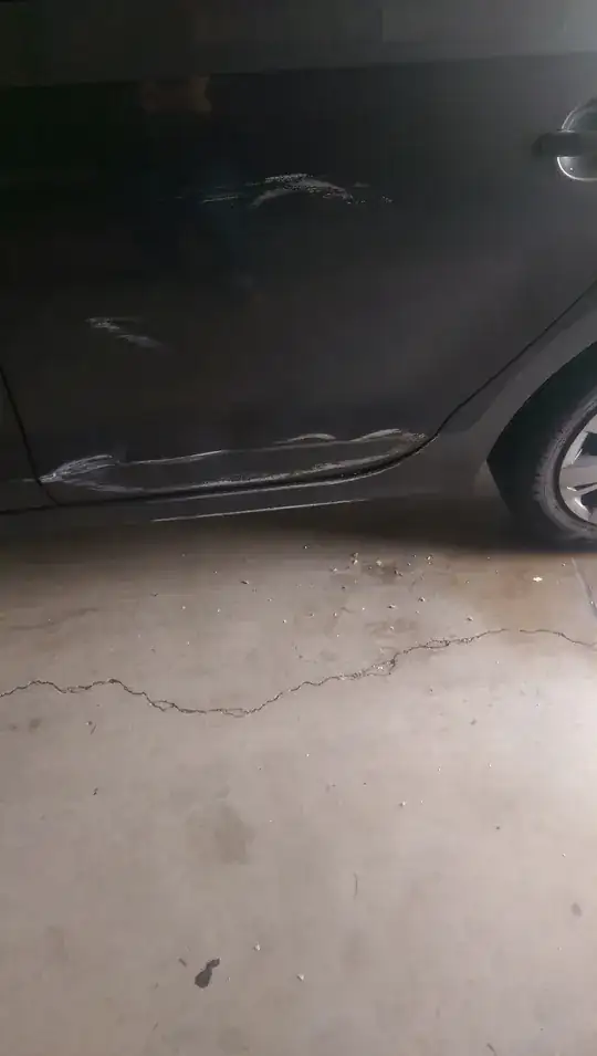

I have a 2012 VW Jetta. The other day I was pulling into my garage and hit the side of the car. There are several dents and paint scratches. What would be the cheapest and easiest way to get this damage fixed? Sorry if this question isn't fit for this stack exchange, first time posting here.
Here is a photo of the damage: enter image description here

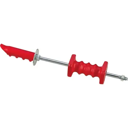

Another Possible Method
glue these plastic ding tabs to the dents. You can find them by googling "plastic ding tab"
You will use a hot glue gun and hot glue them to your various dents.
Use a dent puller slide hammer. The tip should screw into the plastic ding pullers.
Pull the weight of the slide hammer to where the ding tabs are attached to the dent and give it a good pull. When the sliding weight hits the stop at the end of the hammer the transferred energy will pull onto the glued tab and pull the dent out.
You may need to repeat the operation a few times to get the result you are looking for.
