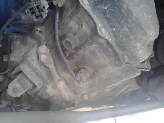

I have a 97 Mazda - 323 S V (BA) - 1.8 i 16V (114 Hp) with a manual 5 speed transmission. While trying to change the oil, I noticed the following connector, with one missing wire on what I think is the transaxel housing:
There is a similar connector on the front driver's side of the transaxel housing ( if that's what it is ). The little red circle is the broken wire, the large yellow circle the "senosr" or whatever it is.
This wire looks like it's been broken a long time, and there's no MIL and last time I connected to the ECU there weren't any error codes present.
I've been looking through the service manual for a similar model ( the 96 Protege ) and so far I haven't been able to find anything. The service manual can be downloaded here.
The section for the transaxel starts on page 394.

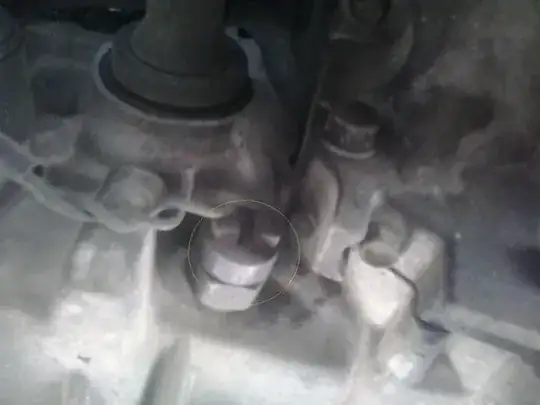

EDIT
Here's a similar looking "sensor" on the front side of the transaxel, next to the driver's side front wheel:

Since you said the reverse lights are still working, it's not the reverse switch.
This switch signals to the engine computer if you are in a gear or neutral. The computer uses this switch to determine several things, including how to handle engine deceleration during shifting and the idle feedback loop. With 1 wire broken, the computer only ever sees this switch in one state (open), which can cause idle issues (especially approaching a stop). Depending on how the computer handles this it may be using more fuel than it normally would, lowering your MPG.
I had this same issue on a 93 Nissan Sentra. The car would sometimes idle about 300rpm higher than normal and ran rich (too much fuel). Different manufacturer, but same concept.
