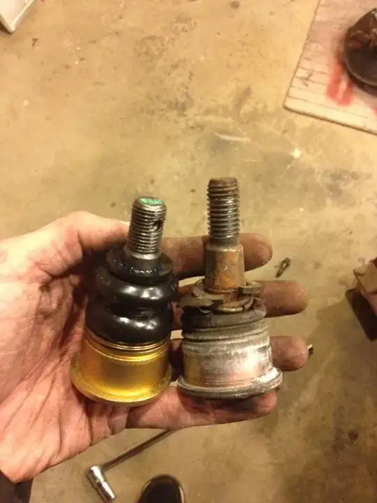

Just for kicks, here is what the new one looks like compared to the old one:
