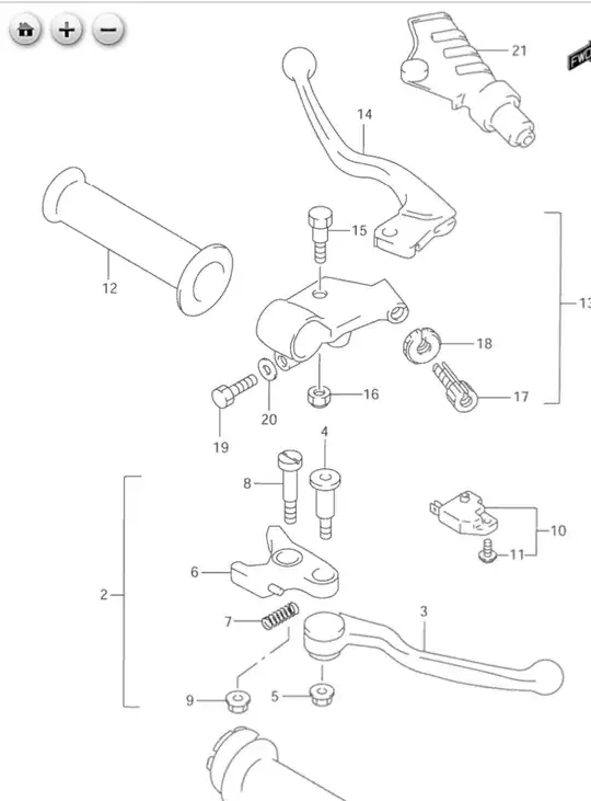

So there is a grounding switch on your clutch lever, hence the need to pull in the clutch to start the motorcycle.
Troubleshooting
You can disconnect that switch and get a piece of wire and complete the circuit at the connector. Once that's done, make sure you're in neutral and then try to start the bike. The switch is labeled 10 in the illustration below.
Solution
If it starts, then you damaged the switch or connector when you dropped it. Perhaps you pinched and cut one of the leads to the switch.
So if it starts check. 1. The switch 2. The connector 3. The wiring attached to the connector.
The switch is $15 new and you can google "suzuki katana \model year\ oem parts" and get a bunch of hits for an online order. Good luck!
