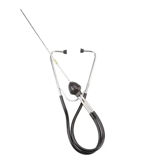

If that doesn't get you which one it is, find yourself a mechanics stethoscope. You can pick one up at Harbor Freight for real cheap.
