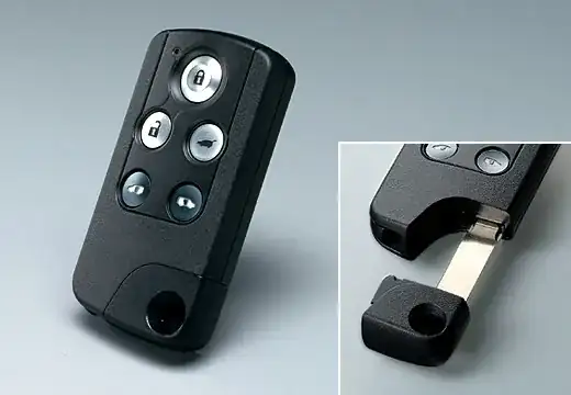

I am new to this forum and this is my first post. I came searching for Honda fit answers and now i am here in the forum seeking for FIT owners help or suggestions.
I bought a Honda FIT 2011 as a second owner for a reasonable price. First owner have lost the smark key and broken the second smart key as he told me.
Now i only have the Key taken from the remote. That is the one and only i have.
Here is a pic of it.
The below part is missing.
Now i have only the half part of Remote which is the key. That is what i am using to lock/unlock the door and to start the car.
1/ I need to know badly how i can get the remote back. So that i can easily lock and unlock the doors.
2/ How to have a extra key ?
Please i would really really appreciate anyone's help or advice on this matter and tell me how much time and cost roughly it would require..
According to this website:
There is no onboard programming procedure for this vehicle. This vehicle requires special equipment be connected to the vehicle to program the keyless remote. Try a locksmith before the dealership, they are usually 50% the cost.
You'll have to purchase a replacement key/fob (or two) and then take it somewhere to have it programmed.
Pᴀᴜʟsᴛᴇʀ2
  • 165,084
  • 32
  • 259
  • 508
According to this source it's possible to program door lock/unlock with a $35 "blank" remote. The immobiliser part of it is unfortunately a bit more high tech (like you would hope). All you need to do is a set sequence with the ignition and remote to reprogram it. I'm not sure if the model's of the fit remote they are talking about and your 2011 are compatible though.
