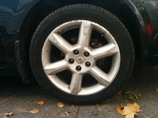

I'm looking to replace rim for one of the wheels of my car (Nissan Altima 06). The wheel specs - 245/45 R18. (Different from the ones that come with the original car)
The rim looks like this - enter image description here
I found similar rims online on ebay, which looked exactly like the one I have; but then I stumbled upon this tire size calculator. After playing around with this calculator, now, I'm not sure how important is the rim width, and what width would be appropriate in my case. I'd appreciate any help in this regard.

The width should be the same width as the one you are replacing. If you don't, it will mess with the stability of your vehicle, how the tire wears, and could possibly (down the line) cause tire failure ... That's probably a little over dramatic, but a possibility. This is, of course if you are just replacing one wheel. If you are replacing them all, width is dependent upon the width of the tire and what it can support in rim width.
