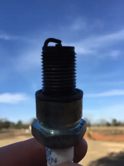

Well, I found out what caused this. The piston is traveling too high in the cylinder and actually running into the spark plug. After riding with a new plug (NGK BR9ES), I took it out and noticed that the ground electrode had been bent all the way to the center:
What could be causing my piston to travel so high and slam into the spark plug? My best guess is something in the bottom end (crank, rods, etc.) is worn or out of place. Am I going to have to replace the entire bottom end? Or maybe just the crank bearings. Any ideas?

My best bet is that the spark plug is too long in the first place. I don't know what the stock spark plug should be for your bike, but the NGK you are showing may/may not be completely within spec and therefor is extending down into the cylinder longer than the spark plug should. If the bottom end was worn out enough to allow the piston to travel that far up into the cylinder, your whole rotating assembly would be shot. Realize that tolerances are measured in 1/1000's of an inch. To come into contact with the spark plug would take 1/10ths of an inch to accomplish. You'd be hearing a lot more banging around happening of this was the case.
RockAuto.com is showing the following sparkplugs for your bike:
  • AUTOLITE Part # XS4063 (Iridium)
  • CHAMPION Part # 89041
  • CHAMPION Part # 686 (racing plug - non-resistor)
  • AUTOLITE Part # 4063 (copper resistor style plug)
I would go to a power sports store with your plug in hand and see if these plugs are noticeably shorter than yours. I'll bet you'll be surprised.
Another thing you might be able to do is to put a second sealing washer on there. This may or may not allow a perfect seal, though. It would definitely pull the spark plug out far enough to keep it out of the path of the piston.
