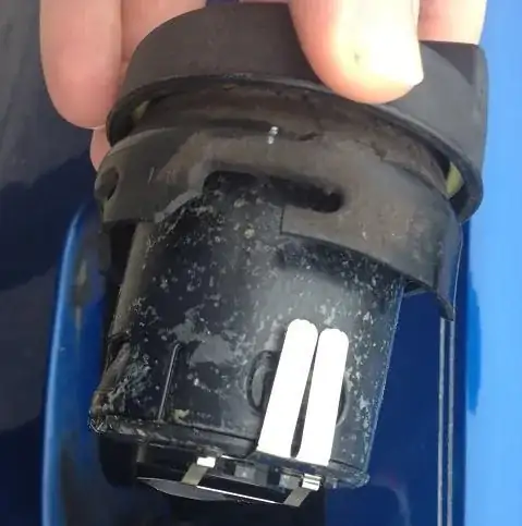

Part that comes out of the gas tank.
In this picture, you can see the part that comes out of the gas tank filler hole. The gas cap is still screwed into it. Notice that it appears as though it is meant to lock into place on the car, but part of the locking mechanism has broken off.

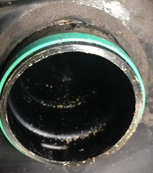

Gas tank orifice with part removed.
This is the orifice where the part plugs in. I assume this is the top of the filler tube leading to the gas tank.

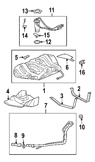

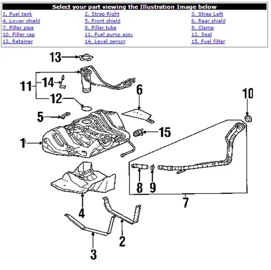

Fuel filler neck or pipe, it connects to a rubber hose (8) that connects to the tank (1). Hose clamps (9) are used to secure the hose. If it come loose from the tank then you need to tighten the clamps. If the filler neck is coming a loose from the fender area then you need to tighten or replace the fasteners there. It doesn't look like it's sold separately based on the two pictures below.
It's item 7 in the pictures below.
Image from www.saturnparts.net
Here's an image from another site.
Image from www.gmpartsonline.net

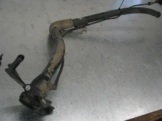

Here is a picture of one off a 2006. I see where I think you are talking about it coming apart but I don't think you can get just that part.
Picture source www.justparts.com
He is correct in that it can come out if the clips break and in my case on an F150 its secure but all beat up and cracked over the years so now the seal (good cap) is interrmittant and can throw and evap code that comes and goes and triggers the engine check light. Ford also only sells tbe whole filler tube @ $318 in my case, gheez... I suggest trying a junkyard if you think you can release the clips without breaking and pull your part. I plan to do this as well or in my case I might try to build up the bevel thats damaged with either fiberglass/epoxy or a gasket sealer resistsnt to oil/gas to fix the seal problem.
