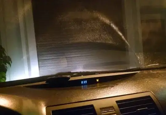

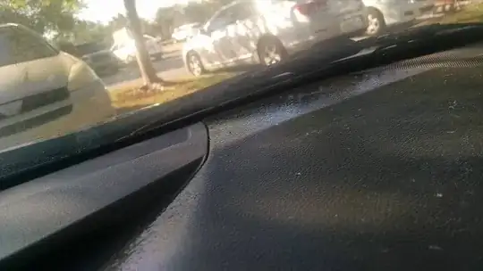

Photo - note the shiny (tacky to the touch) dashboard and accumulated dust.
Example of stickiness/shininess
Photo - note the dangerous nighttime glare created by the shiny dashboard. Glare also exists under direct sunlight, and is much worse.
Example of shiny dashboard at night
