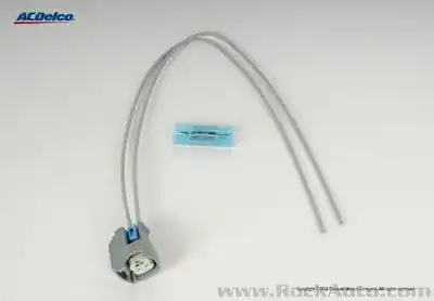

Just replace the injector plug. I believe it should look like this:
You can order it from RockAuto.com for ~$6 (I'm sure you can get it from many other places as well. I would soldier this in place using heat shrink to seal them up.
