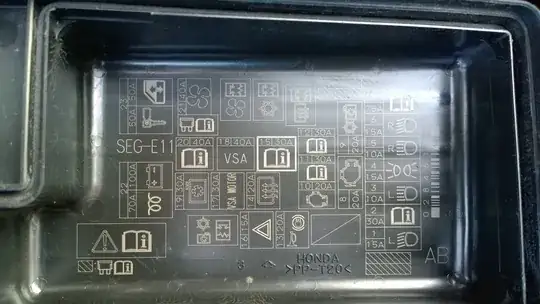

Side marker and full(high) beam working fine, but not dipped (low beam) headlights. Checked all fuses - ok. I looked at the cover of the fuse box above (pic below).
enter image description here Honda Accord 2005 under-bonnet fuse box Lid

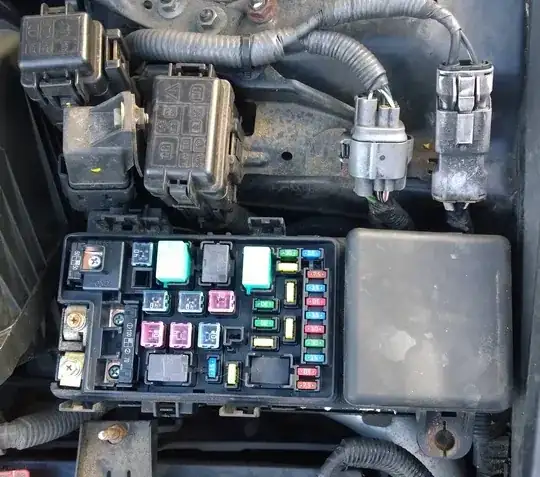

Which covers these fuses & relays: enter image description here
The relays you can see only indicate fan controls, frost (!) and heating. Headlights are only shown in fuses F1,3,5 & 6 and as they are all fine I'm stumped what is causing the dipped main beam not to work. So I had someone switch the lights on and off from side to dipped main and a relay was clicking. Using feel I found the sound and vibration coming from the apparently sealed boxed section on the right of the bottom picture. After much wrangling, this covered portion of the fuse-box does not feel user-accessible even to replace a headlight faulty relay.
Q. IS the headlight relay inside this covered/almost sealed right side of the fuse box? If so how do you get to it?

The headlight control unit is in the sealed portion of the box.
It is a CAN network controller and not just a relay.
If it has failed the whole box is to be replaced.
