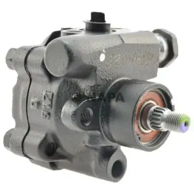

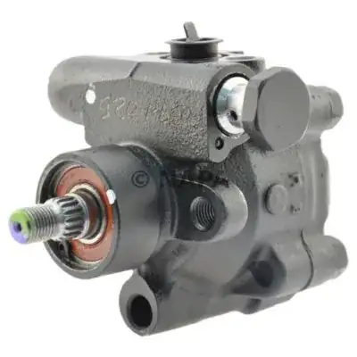

Edit: Screenshots of the power steering pump used to replace the original (link to NAPA listing)
NAPA Power Steering Pump - Right Side Right Side
enter image description here Left Side
