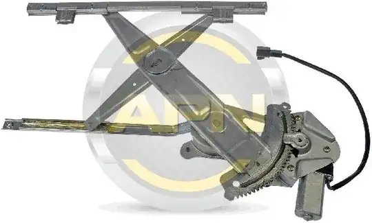

This is what the mechanism should look like. enter image description here
You'll have to find a way to get at the three gold screws that hold the motor to the rest of the assembly. This will allow you to disengage the motor, so the rest of the assembly can move freely.
Be careful: once you disengage the motor the window could drop and break. You'll want to get somebody to hold it, or wedge something under the lift arm (inside the door) so it can't move.
