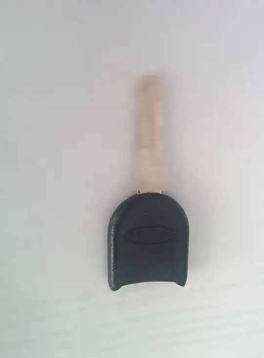

I have a key (for a 2006 Ford Focus), and the bit that attaches it to the keyring has broken off.
I could fix this by drilling a hole in it, and attaching the keyring to that. But it's got some electronic doodads inside it (so you can't just copy the key and start the car with it). Where is a safe place to drill a hole in it? Or how can I work out (without an x-ray machine) where it's safe to drill?!

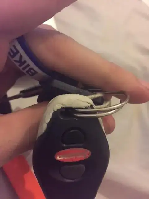

Use some Sugru on it
Sugru'ed my alarm fob back together
It's rubbery in consistency so it won't just snap off when you drop your keys. Use a piece of metal or plastic for the "crossbar" and sugru around it.

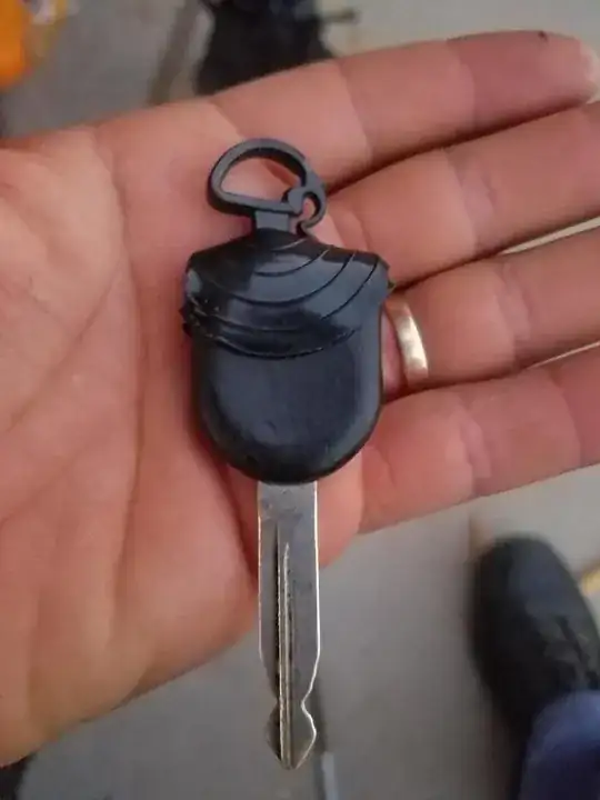

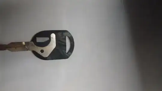

this is a key that the transponder went out on, cut it down with a razor knife. the transponder is a black magnet looking thing, I have it marked in white. as you can see, plenty of room on the upper for hole drilling
