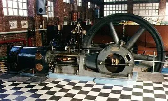

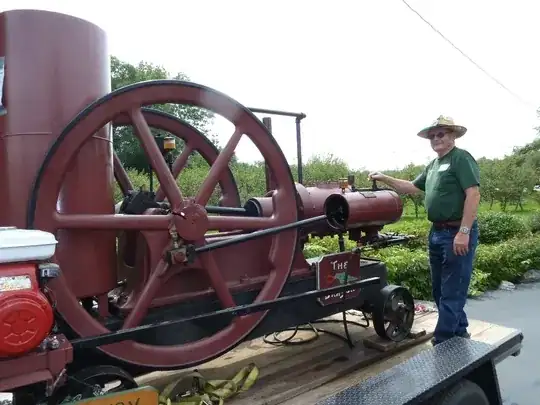

First, it isn't power which is needed, but torque to keep an engine running. In the early days of engines, each had one cylinder and didn't run very fast. To keep it running, it had a very large flywheel attached to it. Once the engine was running, it continued running because there is a little physics statement which says something like, "mass in motion tends to stay in motion" and conversely, "mass at rest tends to stay at rest". The flywheel provides the mass which I'm talking about.
Image pulled from mi.eng.cam.ac.uk (NOTE: This is a single cylinder steam engine, but the same principle applies.)
Image pulled from WZOZ 103.1FM website (This single cylinder gas engine has two flywheel masses, one on each side.)
Today's engines are no different than those of old. They still require the mass to keep on running. Without some sort of flywheel, they will stop running. A manual transmission has a regular flywheel, which is its engine's mass. An automatic transmission has a torque converter, which is the mass for its engine. Without it, the engine will die because there isn't enough mass to keep it going between piston firings. The flywheel mass provides the torque needed to keep it going.
