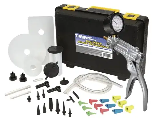

Look for a vacuum hose going through the firewall and trace it to where it hooks up to the intake manifold. It goes through a one way check valve and it teed into a vacuum canister. Do a visual inspection on all the vacuum hoses connecting the items above, looking for holes etc. You also might have a pinhole in the diaphragm in one of the actuators. A vacuum pump like this one pictured below can be helpful in finding the problem. You don't really need all accessories, a standard mityvac can be bought for around $30.
http://www.mityvac.com/pages/products_hvpk.asp

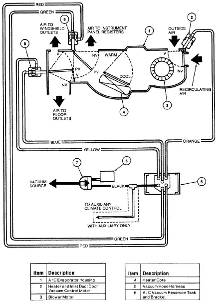

Below is a diagram of the vacuum harness, to give you an idea of how the system works. Most of this is under the dash, except for the vacuum canister (#6) and the check valve (#7)
