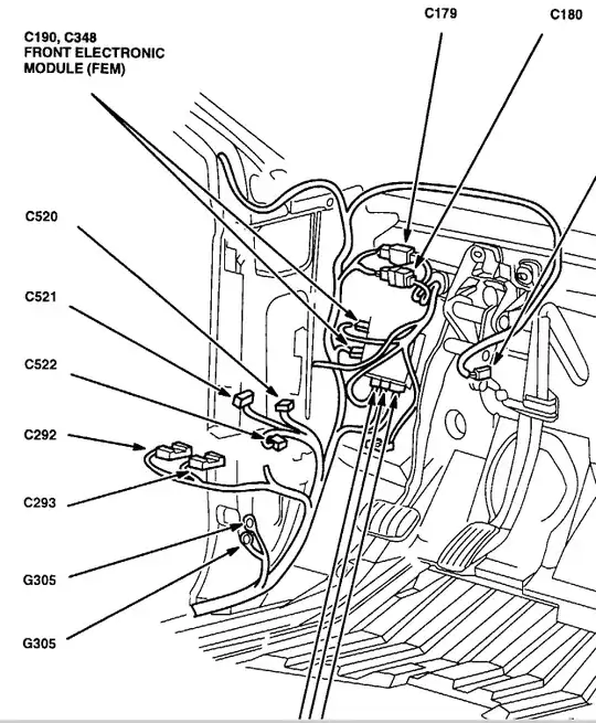

Basically your headlamps are controlled by a computer. The Front Electronic Module (FEM) to be exact. The FEM grounds the headlamps when it wants to turn them on. This system was an early Multiplex design that reduced wire and total circuits where the modules communicate on a single serial line, now referred to as the CAN Bus (Controller Area Network). You will likely need a scan tool to diagnosis the car, and not a cheap one, but a professional model. You many even need a factory scan tool, though I doubt if for a Ford. Outside of security theft deterrent systems they allow the aftermarket professional scan tools to access their systems.
So where do you go from here? With or without a scan tool, the grounds are a good place to start.
G303 are the main ground for the FEM.
G304 is connected via C179 (C means connector) and through S139 (S means splice)
G304 is located behind the LH cowl panel C179 is located behind the LH side of the instrument panel S139 Dash panel to headlamp junction, near T/O to C192 Front Electronic Module (FEM)
You can see the FEM, G304, and C179 in the picture below. Outside of checking the connections and wiring there is not much you can do without a scan tool.
