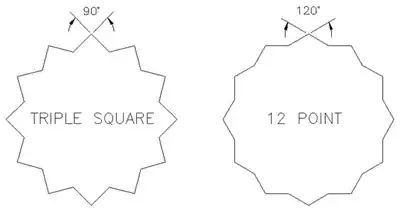

  4. Get the next size up allen key or torx bit that will almost fit into it and hammer it on. I'd recommend doing this with a bit you don't care about, preferably impact rated due to hardness. I'd recommend 1/2" drive for this bit if space allows. If you're wondering what will fit, see this diagram:
    triple square versus 12 point socket
    That diagram shows the difference between your bolt (left) and a 12 point socket (right). Notably, an allen key or torx bit would fit into this. If your fastener is standard, use a metric (and vise versa) to get a size that's just a little bit off (i.e. a little bit bigger).
