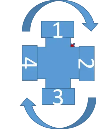

Also, if you replace your u-joint with one which has a grease-zerk, ensure you put the zerk on the compression side between the drive line yoke and the differential yoke. This is imperative as well, because if you don't, the u-joint will fail prematurely at the zerk. The zerk sits inside of a hole. When the zerk is on the compression side, stress is transmitted through the zerk from one side of the zerk hole to the other. When on the tension side, there forms a stress riser with nothing to support the zerk hole, so a crack can form and ultimate failure will occur.
To discover what the compression side is, look at this picture:
First of all, the zerk is the red thing protruding between cap 1 and 2 of the u-joint. The arrows denote the direction of the drive shaft as if you were looking down its length from the front of the car towards the rear differential. This next part might be confusing, so this is from the stand point of the rear u-joint. If the loops of your drive shaft yoke are on caps 1 & 3, while the yoke of the differential is on 2 & 4, then the zerk would be in the correct position to be on the compression side. There is another compression area between 3 & 4. There is a tension area between 1 & 4, as well as 2 & 3. If you are doing the u-joint at the front of the drive shaft, then the transmission yoke would be at the 1 & 3 position and drive shaft at the 2 & 4.
