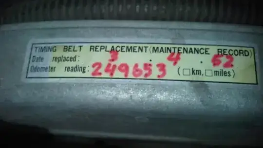

Check around your engine bay. There may be a sticker indicating the last timing belt change if mechanic did stick it.
Something similar to this.
