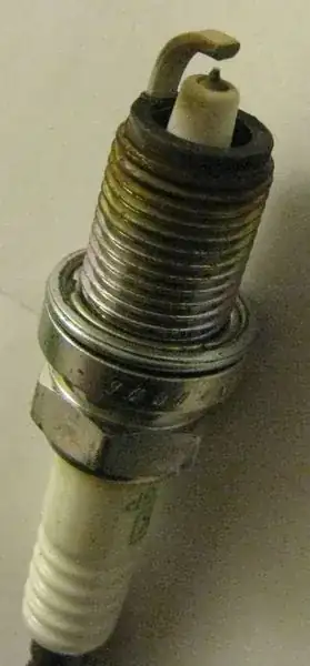

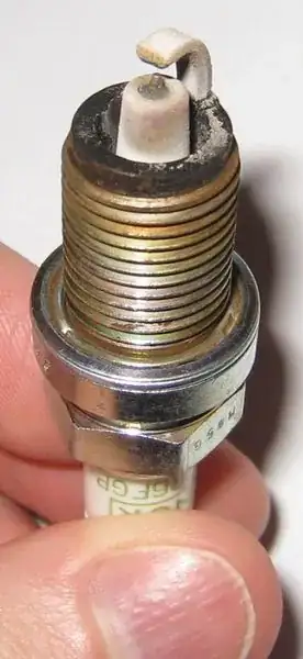

  • I replaced the spark plugs, and the old ones looked like this:Cylinder 1Cylinder 2

Not familiar with Honda ignition systems, but could even be a cracked coil or power transistor case that's allowing moisture in. Acts up until the moisture is cooked out of it.

Possibly a failing fuel pump or pressure regulator. Have the fuel pressure checked in addition to @Rory suggestion.
