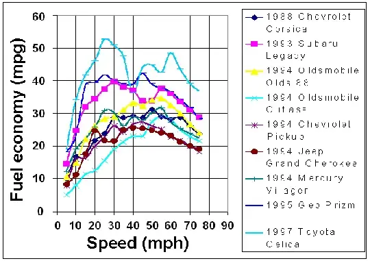

Also keep in mind that increasing speed will increase fuel economy if you are going below a certain speed; that speed varies with the car:
fuel economy curves for various cars
See http://en.wikipedia.org/wiki/Fuel_economy_in_automobiles#Speed_and_fuel_economy_studies for a bit more information.
