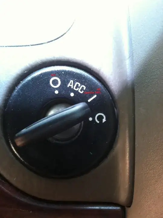

  1. With an unlearned master vehicle key, turn ON the ignition, but not the engine: enter image description here

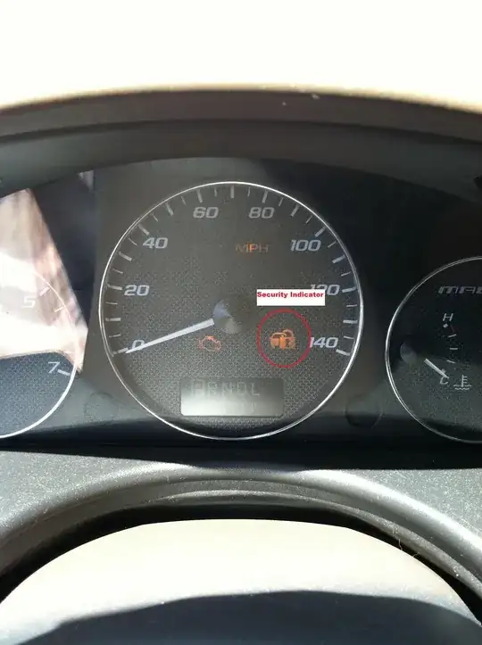

  2. Wait for roughly 10 minutes (mine was slightly longer) for the 'security indicator' to turn off: enter image description here
  3. Turn the ignition completely OFF and wait for roughly 5 seconds
  4. Repeat steps 1-3 for two more times for a total of 3 cycles (roughly 30 minutes)
    • NOTE: it is important to complete all steps of the third cycle, especially step three, as this is how the vehicle learns the key transponder information. In other words, before starting the car, you must turn off the ignition and wait 5 seconds first
  5. With the key you just programmed, turn the key and start the car. The key is now operable on the car.

  2. Watch the 'security indicator' until it's solid

  4. Turn the ignition to ON (engine OFF) and wait until the 'security indicator' turns solid
  5. The Key is now programmed and should now start the car
