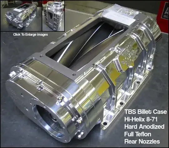

This is a roots style supercharger. Unlike the turbocharger you mention, the supercharger (or "blower") is driven directly by the crankshaft of the engine, via a large belt. Turbos use the exhaust gases to perform the same task. The task at hand is to force more air into the engine than the engine could normally suck in on its own. By doing this, it makes the engine "think" it is bigger than it it actually is and thus produce more horsepower in the process.
Here is what one looks like up close:

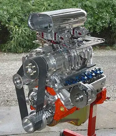

Here is one on an engine:
These do not come stock on cars directly from the factory. They are an aftermarket add-on. Some cars come with different versions of superchargers (like the Pontiac Grand Prix GTP), but nothing like the one you show in the picture.
