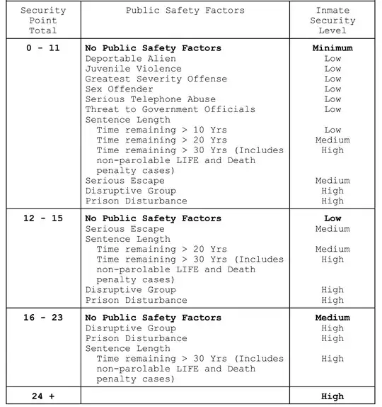

The key table in the rules is below. It is somewhat hard to interpret without the larger context, but is the closest thing to an overall assignment key that exists in the rules. Basically, the left column lists a point score, which provides a default assignment, and each box has exceptions to the usual point score rules:
Medium security inmates either have 0-15 points with a prior serious escape attempt or a sentence of 20 years or more remaining, or 16-23 points. But they have less than 24 points, less than 30 years of their sentence remaining, are not part of a disruptive group (read hard core gang member) and have not been involved in a prison disturbance. The circumstances that gets someone to 16-23 points are not simple to describe succinctly.

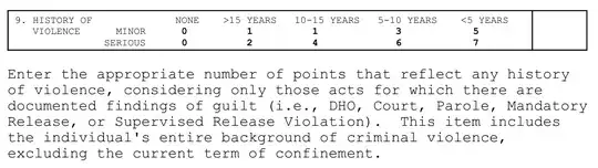

  1. History of violence. In assessing the violent nature of prior documented findings of guilt (convictions and supervised release violations), policy distinguishes between “serious” and “minor” incidents as well as time relative to when the case is being reviewed. This category does not factor in the instant offense and can change over time based on an offender’s institutional adjustment (i.e., violence in the BOP can result in assignment of points).
The rule provides with regard to this factor:
  1. History of escape or attempts. Acts for which there are documented findings of guilt, including absconding from community supervision or failing to appear for a criminal case, will be scored.

An inmate’s security point total corresponds to a security level from which staff determine facility placement. However, security point total is not dispositive. The application of a public safety factor (PSF) or a management variable can impact the placement decision. The application of a PSF, which is not confined to evidence of convictions, is intended to address information suggesting a need for greater security precautions. Examples include sentence length, removable alien status, sex offender status, and threat to a government official. Management variables are grounded in the “professional judgment of bureau staff” and are used to effectuate an inmate’s placement at a facility inconsistent with the inmate’s scored security level. This most commonly occurs when an inmate poses either a greater or lesser security risk than his or her assigned security level denotes or to facilitate program participation (e.g., permit completion of residential drug treatment despite a drop in security level).
