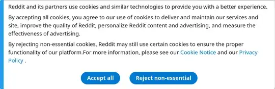

For example, I'm fairly happy with the current Reddit cookie notice:
Why this is a good notice:
  • it explains the data controllers (Reddit and partners)
  • it summarizes the purposes for which consent is sought
  • it links to more detailed information
  • the presented options “accept all” an “reject non-essential” are less ambiguous that “accept/decline”
Comparing this with the list of minimum required information for informed consent in section 3.3.1 of the EDPB guidelines linked above, the following information is missing though:
  • the identity of the “partners”
  • what (type of) data will be collected and used
  • the existence of the right to withdraw consent
