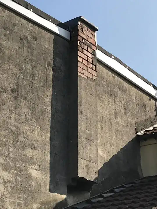

I live in the United Kingdom. When we purchased our house recently it what not brought to our attention at the time but the neighboring property has a disused chimney stack which appears to have been cut by a previous owner of our house to make way for a single-storey extension. This does not appear to have been done correctly as my understanding is that a gallow bracket should have been fitted.
To make matters a little more interesting our extension was built without planning or building regs approval approximately 20 years ago, but we do have an indemnity policy which we believe covers us which was taken out two owners previous in 2006.
