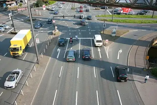

Answer for the video linked in a comment (snapshot below) and assuming the siren is actually on (which is plausible but the gif video doesn't have sound, and in Germany the Sonderrechte-magic requires blue flash light and siren)
snapshot of the video linked in the comments
Are the driver's actions [staying where they are until green, then starting] legal in this situation
NO - they need to immediately make way - unless the fire truck had their siren off. In that case they behaved as they should.
is the driver required by law to enter the intersection on red in order to make way for the emergency vehicle?
Also NO since there is no necessity: they have sufficient space before even violating the stopping line to move sideways and forward so that the fire truck can pass.
(If there is really no other possibility to let the emergency vehicle pass, then yes they may have moved into the crossing)
Details:
Since the car is stopped at the stop line, they cannot move out of the way without entering the intersection
For most cars at most traffic lights this is not true. (Fully-grown trucks and cars with trailer may have more difficulties, though. Also, e.g. construction sites may restrict the space where one can put the car. But yes, you'd be supposed to fold in your mirror and e.g. move up a tunnel's safety strip "pavement" if that's what is needed)
First, one is supposed to stop well before the holding line and subsequent cars are supposed to leave adequate distance as well. One of the reasons for this is to have maneuvering space to move the car sideways (really squeeze to the side of the lane or go on the sidewalk or embankment) in order to give way for emergency vehicles.
Consider the video: The green car on the 1st lane has (in an exemplary manner) left plenty of space even before the stopping line. They could thus have used it to move far to the right, which would have given the fire truck sufficient space to pass. Yes, the red car on the 2nd lane may have helped as well by moving further to the left.
(BTW, note that the fire truck is labelled in German: Feuerwehr)
Second, intersections with traffic light are on purpose designed with space between the stop line and the actual traffic light which in turn is placed well before the actual intersection begins:
photo of crossing with traffic light showing space between stop line, traffic light and actual beginning of the intersection source
Also, the general ban on stopping and parking near crossings means that there are no parked cars keeping you from entering the sidewalk or embankment.
Thus, in case one nevertheless finds oneself without sufficient space before the stop line, there is the additional safety zone even before the actual traffic light.
