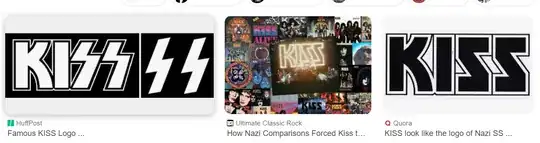

So, let's compare the old and new Logo from this snippet from google, which helpfully includes a direct comparison with the banned SS logo.
It's easy to see the alleged closeness in the press release. A Berlin court in 2016 found that the original logo is allowable, because KISS as an international mark would be recognizable as for KISS and nobody would think earnestly it was a banned SS rune, especially with the aspect ratios being off. Still, KISS uses the newer font style.
