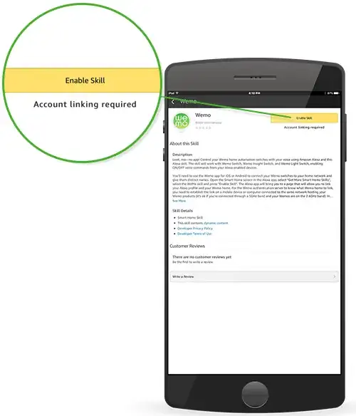

I am using the Alexa web interface to configure the Amazon Echo Dot. When I try to enable skills per the below image, I am unable to enable the skills.
wemo skill in alexa app - activation screen

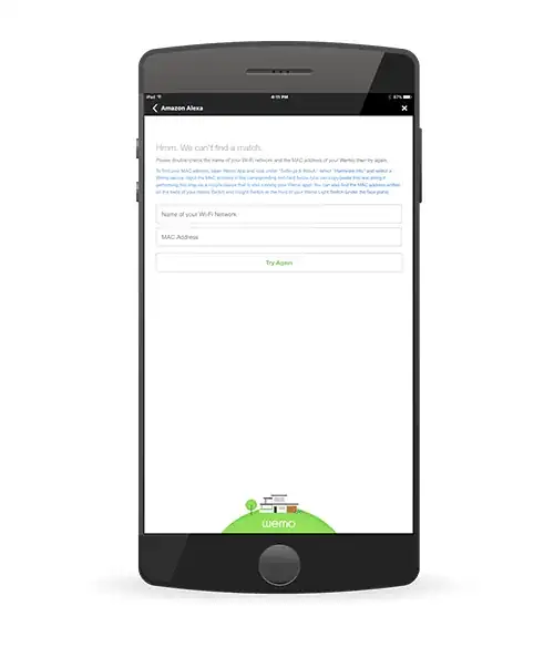

The application presents a UI as below, but I am unable to proceed any further.
wemo login screen

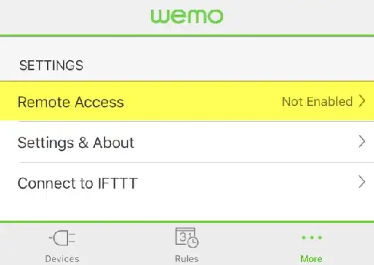

Per my research I have tried to enable remote access using the following menu option.
wemo settings
When I try to enable remote access I get the following error
Sorry, we were unable to setup your remote access just now. To try later go to More > Remote Access
