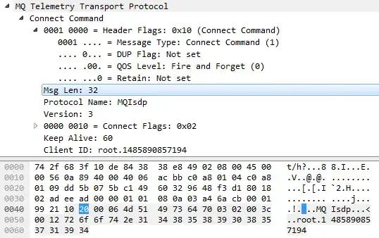

Currently I do not build my own CONNECT message but use one from a Wireshark capture.
Wireshark Capture Screenshot
It can be exported as a C array, the MQTT part:

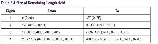

I know that the Remaining Length field requires special enconding but not under 128.
Remaining Length Table
What did I miss here, what should I modify beside the Remaining Length field?
