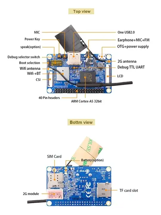

I recommend an Orange Pi 2G IoT. They also have a 4G model.
Here's the 2G version, which is considerably cheaper & ought to be enough:
[Additional] I am very fond of the Orange Pi line, as it has long had things like a SATA controller, etc available and generally has a wider selection than the Raspberry Pi range.

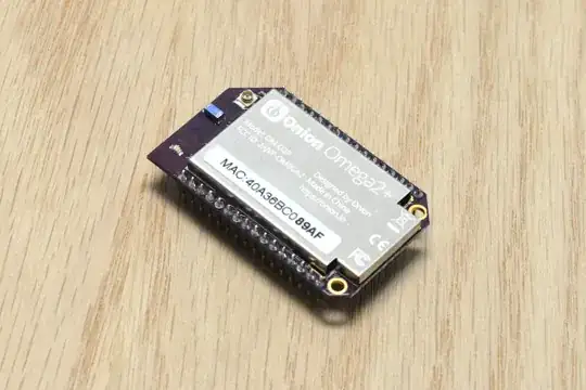

However, the Onion Omega 2, is my favourite and, IMO, superior to any pi, but since it has no cellular capability is not the answer here; I just post this to help others).
Two things that make it stand out are than it comes pre-load with Linux - in flash, and that, out of the box, it acts as a sever, so that it is straightforward to connect by WiFi. Check out the spec. There is also a new version which is pricey at $49 but which has 8GB flash, as opposed to relying on micro SD card.
The Omega 2 range is not much bigger than a large SIM card.
