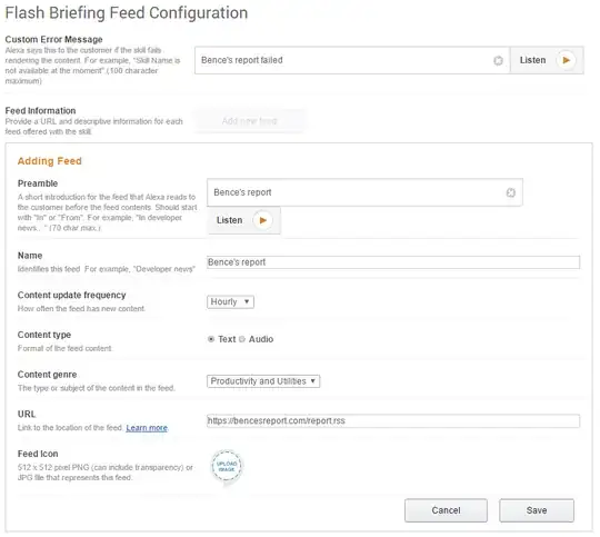

The latter one is triggered by Alexa, give me the news. In the Alexa app you're able to define which Flash Briefing skills are triggered. Those can be several and they can be ordered however you like. If you're okay with the report you want to build to be in these information you can consider this skill type. The advantage of course being that the API already has a lot of stuff built in. The disadvantage is that your report is lodged in between the news report of the NY Times and the NBA results or whatever else you configure to be in your Flash Briefing.
The Flash Briefing API is what's actually triggered when you ask, Alexa, what happened today? It's one of the invocation utterances for the flash briefing. So your dream utterance is already pre-defined to use this and if you're set on the phrase it's even the only solution.
Since the interaction model is pre-defined there is only one Alexa skill page to configure.
FlashBriefingAPI
Then you'd only have to provide an rss-feed with the information as described here in the documentation. If you don't want to publish the information—which I assume considering the example—you don't need to publish the skill either. It will only be available for you(r Alexa account).
Drawback is that the feed cannot be password protected, which means essentially you can only use firewall rules to filter for the IPs the usual Alexa requests come from. If you build a custom skill with the custom model you can secure all you want.
