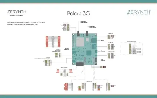

I have tried plugging both a wired in ear headset into the headphone jack and an amplifier connected to a speaker. The in ear headset makes no noise at all while the speaker is constantly buzzing loudly, also while no data is being sent. I have attached an image of my board layout. The MP3 Click is inserted into the micro bus of the board. Polaris NB IoT board
