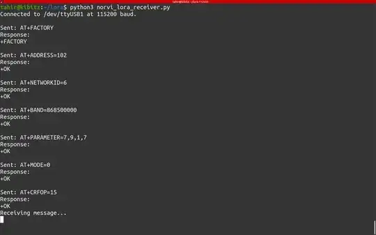

# NORVI receiver
import serial import time
def setup_lora_usb(port, baudrate=115200, timeout=1): try: ser = serial.Serial(port, baudrate, timeout=timeout) time.sleep(2) # Wait for 2 seconds to allow device initialization print(f"Connected to {port} at {baudrate} baud.") return ser except serial.SerialException as e: print(f"Error connecting to {port}: {e}") return None
def send_at_command(ser, command, delay=1, read=False): if ser: ser.flushInput() # Clear any data in the input buffer command_with_newline = command + '\r\n' ser.write(command_with_newline.encode("utf-8")) # Send command time.sleep(delay) # Wait for response response = ser.readlines() # Read all lines from the response print("Response:") for line in response: try: print(line.decode('utf-8').strip()) except UnicodeDecodeError as e: print(f"Error decoding line: {e}") def main(): try: port = '/dev/ttyUSB0' ser = setup_lora_usb(port)
if ser: send_at_command(ser, "AT+ADDRESS=102") send_at_command(ser, "AT+NETWORKID=6") send_at_command(ser, "AT+BAND=868500000") send_at_command(ser, "AT+PARAMETER=7,9,1,7") send_at_command(ser, "AT+MODE=0") send_at_command(ser, "AT+CRFOP=15") print("Receiving message...") while True: if ser.in_waiting > 0: response = ser.read(ser.in_waiting) print(response.decode('utf-8').strip()) time.sleep(2) else: print("Failed to connect to the device.") except KeyboardInterrupt: pass
if name == "main": main()

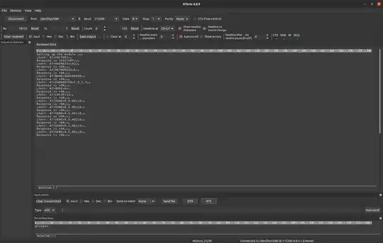

// ESP32 controller where NORVI LR406 is connected
#define RTLX_RX 0
#define RTLX_TX 25
HardwareSerial lora_serial(2);
String sendCommand(String command)
  lora_serial.println(command);
  delay(1000);
  Serial.println("\nAttention command sent to LoRa module: " + command);
  String response = "";
  unsigned long startMillis = millis();
  unsigned long timeout = 5000;
  while (millis() - startMillis < timeout)
    if (lora_serial.available())
      response = lora_serial.readStringUntil('\n');
      break;
  Serial.println("Response is " + response) + "\n";
  return response;
void setup()
  Serial.begin(115200);
  Serial.println("Setting up the module \n");
  lora_serial.begin(115200, SERIAL_8N1, RTLX_RX, RTLX_TX);
  sendCommand("AT+ADDRESS=101");
  sendCommand("AT+NETWORKID=6");
  sendCommand("AT+BAND=868500000");
  sendCommand("AT+PARAMETER=7,9,1,7");
  sendCommand("AT+MODE=0");
  sendCommand("AT+CRFOP=15");
void loop()
  sendCommand("AT+SEND=102,5,HELLO");
  delay(2000);
  // while (Serial.available())
  //   int inByte = Serial.read();
  //   lora_serial.write(inByte);
  // while (lora_serial.available())
  //   Serial.println("Lora serial is available");
  //   String inByte = lora_serial.readStringUntil('\r\n');
  //   Serial.println(inByte);
EDIT 1
Currently I am using both NORVI modules based on REYAX. As both of these will have same instruction set. For sender side I am flashing the code to an esp32 based controller. For receiver I have connected the NORVI module to a serial to ttl converter and Python code is running for that device.
