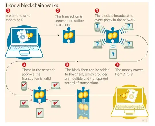

How, exactly, would a blockchain system provide such protection to a network of connected devices?
Below is a quick breakdown with a source explaining with an example in more detail but essentially it makes it so there are multiple approvers that approve a transaction, some level of access, etc. so if something slips through the cracks of one, it still has to make it through the other levels of approval.
World Economic Forum explains it on their website as follows:
What is blockchain?
Currently, most people use a trusted middleman such as a bank to make a transaction. But blockchain allows consumers and suppliers to connect directly, removing the need for a third party.
Using cryptography to keep exchanges secure, blockchain provides a decentralized database, or “digital ledger”, of transactions that everyone on the network can see. This network is essentially a chain of computers that must all approve an exchange before it can be verified and recorded.
How does it work in practice?
In the case of Bitcoin, blockchain stores the details of every transaction of the digital currency, and the technology stops the same Bitcoin being spent more than once.
picture about how blockchain works
From World Economic Forum: All you need to know about blockchain, explained simply
