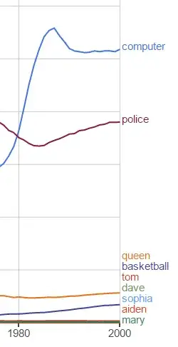

ngram of computer versus other words
This Ngram shows the two most popular US baby names of 2016 (for currency), as well as Tom and Dave also flatline against computer. Queen, basketball and police manage to register properly. Anyhow this gives us an idea why Computer, Earl Grey, Hot hasn't been allowed so far. People use the word computer way too often.

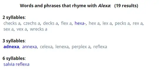

One more thing about false positives. Alexa rhymes with virtually nothing one would say.
19 things that rhyme with alexa
Computer rhymes with 74 things.
