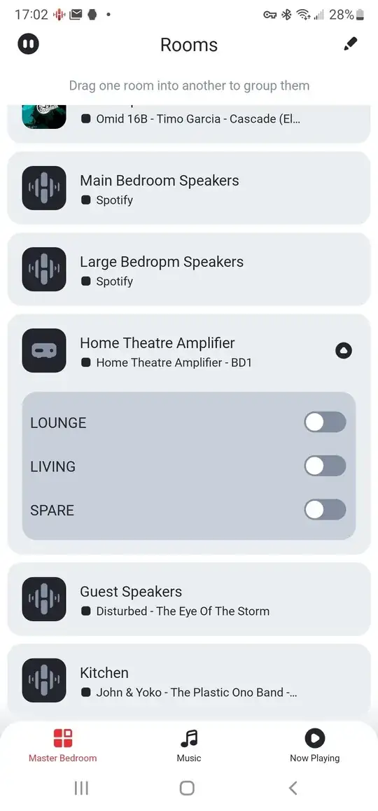

I am using a Heos / Denon system. I have speakers in each room with home theatre support in two rooms (Living and Lounge). For some reason these two rooms are permanently grouped together.
I can group others and ungroup them. A can even drag another room into this fixed group and remove that room. I just cant separate the Lounge and Living. This causes confusion sometimes when the wrong speaker starts emitting sound after its companion is switched off.
Normal drag out or pinch out has no effect on this set. How can I ungroup them?

Finally had an answer rom teh installer. It may help others.
Lounge/Living HEOS: These 2x zones are on the Denon AVR. There is only one HEOS streamer input, so you can only switch zones on/off and not ungroup. All other HEOS zones are fully matrixed with a HEOS streamer per zone.
