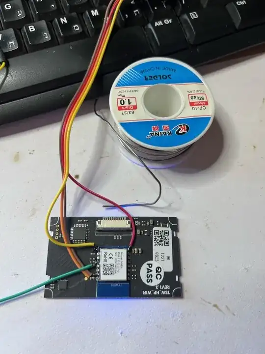

I wish to use a new smart water heater with Tasmotashown.
MCU is TYWE3S, and it has a ready made tutorial which was carried out as planned. Installation succeeded.flahing.
BUT after flahing and assmbling it all back:

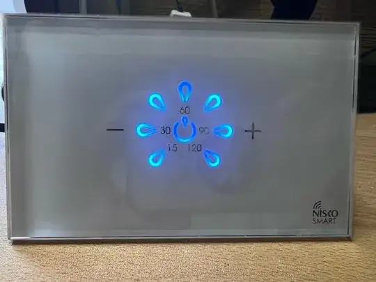

  1. front panel works regardless tasmota is now installed (colors, timeouts and on/ off button + hearing the relay latches),
  2. It seems Tasmota is not controlling anything (any GPIO assigned as relay did'nt operate the relay remotely).

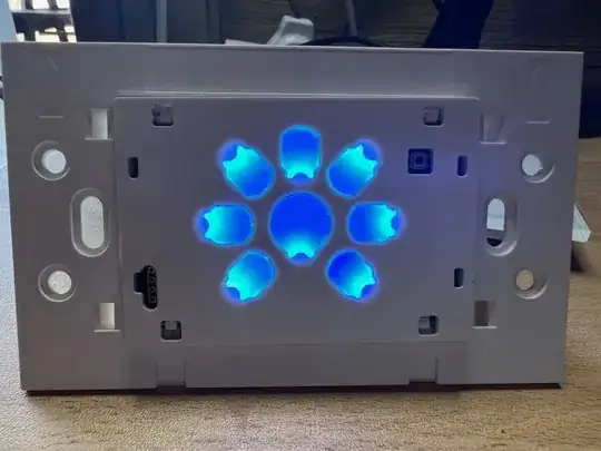

  3. Assembeld pic1 pic.
