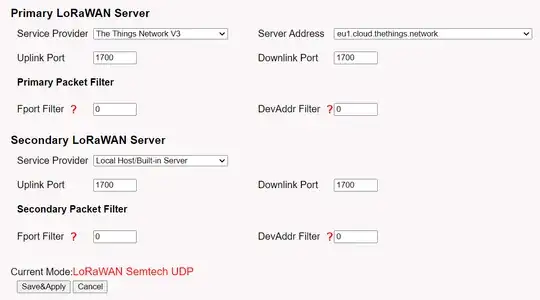

  • configure GW's LoRa parameters (frequency plan)
  • configure built-in LoRaWAN server (semtech UDP). As mentioned in the Dragino documentation, I selected as primary LoRaWAN server The Things Network V3, and as second server Local Host/Built-in Server
Gateway's LoRaWAN setup

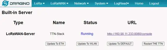

  • Register gateway in The Things Stack Open Source by clicking the link in the GW's configuration page (System -> Built-in Server)
Link to The Things Stack Open Source

  • change the Dragino GW's primary LoRaWAN server to Local Host/Built-in Server and disable the secondary one
And it worked. The reason why there was no Join Accept is because the end device had the wrong keys (AppKey, DEVEUI, etc), and the primary LoRaWAN server was not correctly configured.
