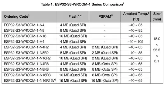

Only after looking at the ESP32-S3-WROOM Datasheet, I realized that there are packages without PSRAM, and that the one sitting on my desk was one of them (ESP-S3-WROOM-1-N16).
ESP32-S3-WROOM-1 Series Comparison
After erasing and re-flashing the Firmware, I am now able to use Micropython on the ESP32 with the 512KB of internal RAM (the warnings still appear, however).
