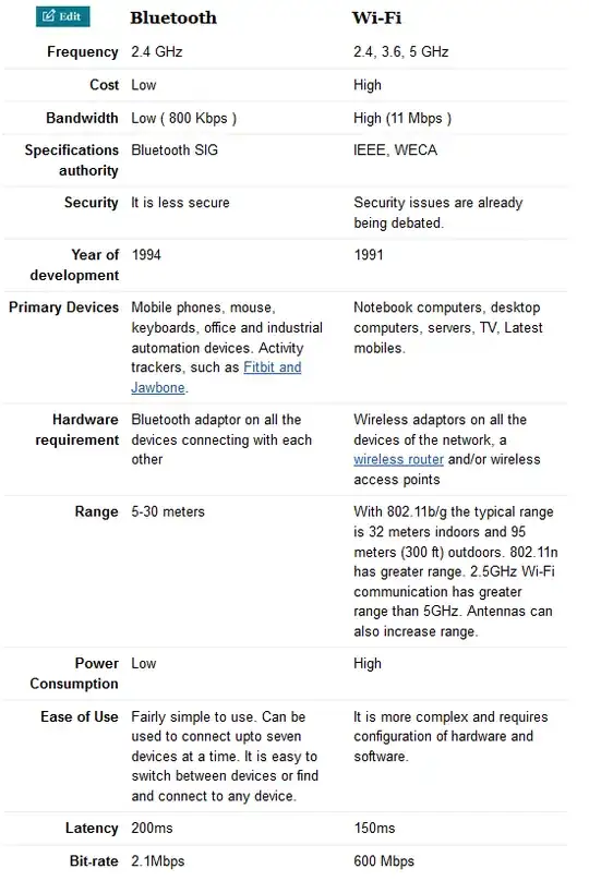

Now I know the basic advantages and disadvantages of the two compared. It is listed at this site Bluetooth vs. Wi-Fi (the image is taken from here as well).
Comparison of BlueTooth and Wi-Fi
To highlight: Some Bluetooth is cheap and easier to use. However, Wi-Fi is more secure, has a higher range and bandwidth but, of course, costs more.
So the question is: At the dawn of a project, how can one decide which one will be the more suitable for the task? I consider the scalability as the most important spec.

Wireless and Bluetooth are very close technologies. But, when to choose between one of them you have to consider many things.
Speed:
Bluetooth 4.0 offers 25 Mbps while WiFi Direct can offer you 250 Mbps. So if you want a faster transfer rate, i.e. if you need to transfer large amount of data within a short time, and it is your main concern, go for WiFi.
Range:
Bluetooth 4.0 has three different types, where the range is mostly device dependent. But we can expect 100 ft to 200 ft range from it. WiFi Direct has a range of around 600 ft, which can be vary on the real world scenarios, but seemingly, wifi can transfer data to longer distances.
Security:
WiFi Direct is using WPA2 with AES 256-bit encryption, while bluetooth 4.0 uses AES 128-bit encryption. But both of these security measures can provide enough security for most of our tasks. Why bother?
Power Consumption:
Bluetooth 4.0 has a separate mode called Bluetooth Low Energy (LE) where power consumption is very low. WiFi Direct in the other hand has also been said it have low power consumption, but in this case Bluetooth is probably the winner.
Cost:
When we build IoT devices, we also have to consider the cost. Bluetooth is clearly low costing technology, where WiFi is still somewhat expensive. This should also be concerned when you select the technology.
So, you can select any of these technologies according to your need.
