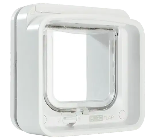

I'm considering buying the Sure Petcare Microchip Cat Flap Connect.
pet door photopet door illustration
I like the idea of being able to set a schedule for when my cat is allowed to exit the house and also to control it via the internet when I want to change the schedule temporarily.
It says "You’ll need [to also buy the $85] Hub to use the Sure Petcare App."
The app gets terrible reviews. So I likely don't want to use it if I can avoid it.
I'm a software engineer and am new to IOT hacking.
I'm curious whether there would be some way to buy just the cat flap (and not the hub) and write my own software for controlling it (if the cat flap could connect to my wifi network somehow).
Where could I learn how to do this?
