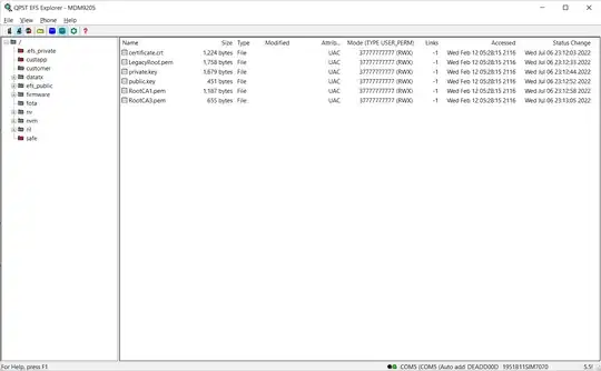

I've uploaded the certificates to "customer" directory to the SIM7070G module using QPST EFS Explorer utility: enter image description here
