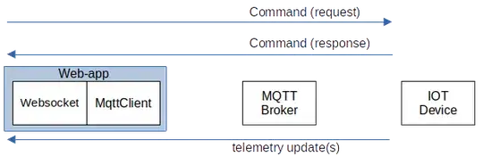

I have built a prototype (which currently only works with a single IOT device) using a NodeJS back-end by using a MQTT client and socket-io (web-sockets).
Current prototype
I understand it's not the convention to see request/ response over a pub / sub mechanism, however the MQTTv5 spec supports a request / response pattern and MQTT plays nicely with constrained devices. Honestly I'm not really aware of what a suitable substitute for MQTT would be for this project. Also note I discarded the idea of a 'MQTT over web-sockets' client library (ie: Paho mqttws) as it exposed too much information about the MQTT broker.

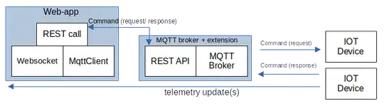

I'm now extending my prototype towards supporting multiple IOT devices, my thinking is to continue using MQTT client -> web-socket to receive real-time telemetry updates and to use a REST API to issue commands to devices. HiveMQ provides an extension framework in which I intend to build the REST API as an extension on the MQTT broker.

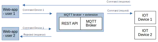

Lastly, as I continue to extend this project I will need to find a way to handle the event in which two users each try to send a command to a device at the same time. My sense is that using a REST API makes this issue easier to solve as there is a central point in which I can handle / block a second command being issued at the REST API and can avoid the message being pushed to the MQTT broker.

If you need to scale this to thousands of devices, I would not have the bottleneck at the cloud, of trying to prevent a second command.
Instead, I'd let the device have the concept of a "session", which starts when a certain command is received and ends when the execution ends or an explicit abort command is received.
When the command session starts or ends, that fact can be broadcast so that all UIs can know. If there's a second command that comes in before the UIs can block it, the device can return a "session ongoing" error (unless the command is for an explicit abort).
Yes. Just make sure that the device does not try to process multiple IoT messages in parallel. This way, your cloud piece can scale and you will be easily (relatively) move it to other IoT platforms if needed.
