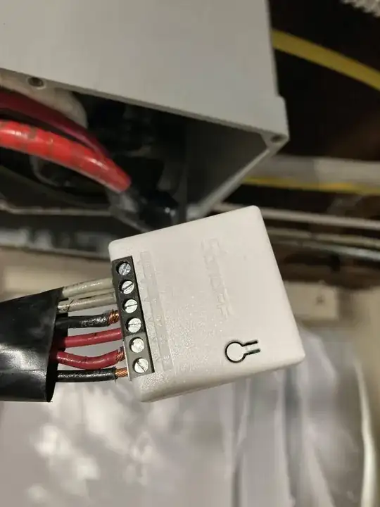

I have 2 Sonoff Mini R2's installed as a part of some remodeling work I'm doing on my house:
sonoff mini r2

Incidentally, I can tell why these devices don't have a UL rating. I had a heck of a time connecting my 12 gauge wires to them without them popping out. The wires for my second device as threaded 12-gauge and that seemed nearly impossible to connect securely.

Oh, one last thing. When you finalize your wiring, make sure that you don't have any bare copper sticking out of the device like that! That's just asking for a fire-starting arc to happen between the two hot wires. For the Shellys, you do not have to strip very much insulation off, and it looks like it's the same for the Sonoff. Snip the ends of the wires a bit to ensure the insulation butts up against the device housing.
