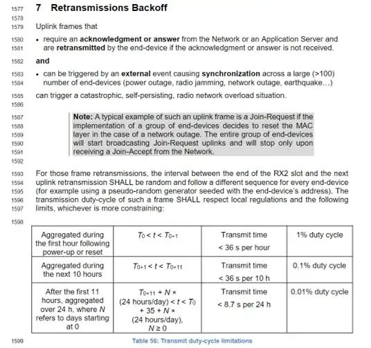

Joining and exponential back-off
The LoRaWAN spec imposes a Duty-cycle for Join (common to all region), which is designed to avoid the network being locked-up in a traffic storm.
Extract of LoRaWAN 1.0.4 specification
The duty cycle back-off is applied per band. For example, the IN865 region uses a single band: BAND0.
  • Within the first hour, the duty cycle = 100 .
  • Between the first hour and the next 10 hours, the duty cycle = 1000 seconds
  • Above 11 hours, the duty cycle = 10000 seconds
Abeeway trackers follow the LoRaWAN specification, however, a button press will skip the wait timer at the application level and trigger an immediate Join. Because this is a user triggered action, it cannot cause a message storm.
