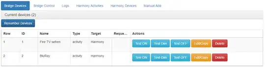

I installed the ha bridge github project on my Raspberry Pi, mainly to see what it can do. I literally just followed the first few steps, downloading and starting the habridge. To my great surprise my Logitech Harmony Hub seems to freely share all his information with the new bridge. I have not entered any credentials whatsoever. The only thing I provided was the Harmony's IP address and a bogus device name (i.e. my hub has actually another display name for all Logitech and Alexa purposes).
SharingHarmonyHub

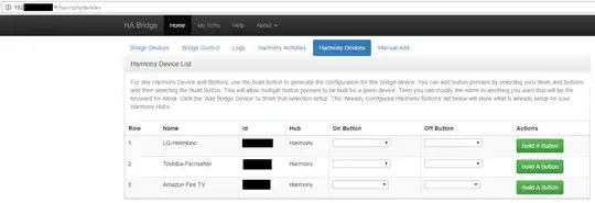

Not only does the Hub share information about all configured devices, it also allows those activities to be triggered freely. I tested it, they work splendid.
EveryonePushButtons
I have looked in both the desktop program as well as the mobile app. Neither seems to offer any way to activate any security options.
