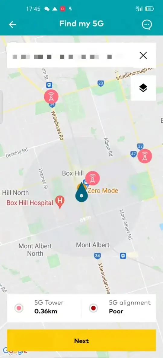

Hi guys,
An interesting found, a few days ago, I was trying to pointing my 5G router to the direction of 5G signal tower. After made a call to my mobile phone service provider, I installed an My Account app.
By using this app, I am able to find the correct direction for my 5G router to point to. Here is how it looks like:
As you can see that the pointer in the middle of the screen rotates when I rotate my mobile phone.
Isn't this the exactly functionality I am looking for?
Does anyone know how it is achieved? Could this be the gyro sensor???
I can't figure out why I had been ignoring gyro sensor the whole time, but it looks like the device I'm looking for, right?

With direction-finding, you usually need a bunch of coordinating devices working together to estimate direction. Look at Silabs white paper for Bluetooth 5.1 AoA and AoD. I don't think this tech is ready for a hobbyist just yet. But, if you've got experience with development kits, then go for it. Silabs has a BG22 module that you could look at.
